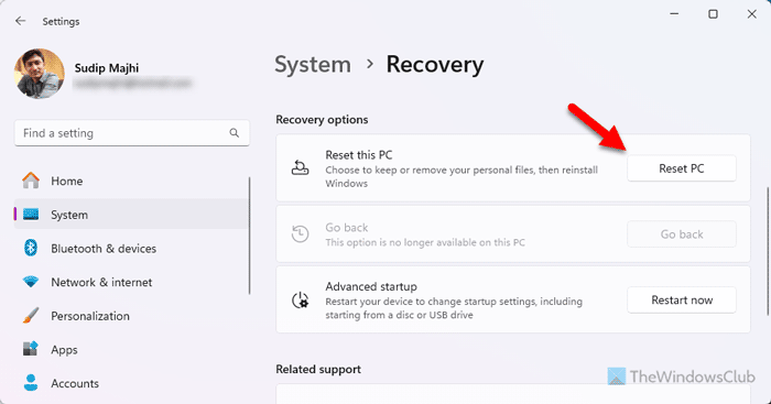

It depends on many things. On a basic level, when you reset Windows 11/10, it reinstalls Windows 11/10 again. That solves a lot of problems, especially file corruption, on the computer. You can either reset using System > Recovery > Reset this PC, or you can choose to boot into Advanced Recovery mode or use the recovery drive or installation media if nothing else works.

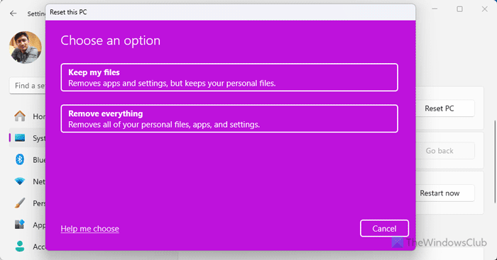

What happens when you Reset Windows 11/10?
There are mainly two things you need to keep in mind since you will get two options when resetting a Windows 11/10 PC. They are:
- Keep my files
- Remove everything
Let’s take a look at these two options in detail so that you can choose the right option depending on the situation.
Keep my files
The Keep my files option removes all the third-party apps, settings, drivers, etc., but it doesn’t delete any personal files. However, your pre-installed apps will not be removed or uninstalled but their settings will be restored to factory defaults.
In simple words, these are things that happen:
- Reinstall Windows 11/10 and keep your personal files.
- Removes apps and drivers you had installed.
- Eliminates changes you made to settings.
- Excludes any apps your PC manufacturer installed.
If your computer comes with preinstalled Windows 11/10, it will also install the apps from the PC manufacturer.
Read: What happens if you interrupt Reset Windows
Remove everything
Unlike the first thing, the Remove everything option deletes everything. That being said, all your personal files, third-party apps, settings, drivers, etc., will be reset instantly. These are the exact things that happen in the background:
- Reinstall Windows 11/10 and remove all your personal files.
- Removes apps and drivers you installed.
- Removes changes you made to settings.
- Removes any apps your PC manufacturer installed.
- Installs preinstalled apps that came with the pre-installed OS in the PC.
Keep my files vs. Remove everything: When to choose what?
You should choose the Keep my files option when your computer is not working as expected after installing an application or driver. If your apps’ settings are acting weirdly, this is the option you should opt for.
On the other hand, you should choose the Remove everything option if you are planning to donate, recycle, or sell your computer. It will completely wipe your data. The process usually takes a lot of time to make it harder for other people to recover files directly or use the software.
