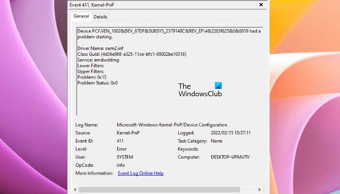

After experiencing issues on Windows PC, when users investigated the cause in the Event Viewer, they saw the EventID 411 with the log name “Microsoft-Windows-Kernel-PnP.” If you are under the same situation, the following solutions will help you fix the Kernel-PnP Event ID 411 on Windows 11/10.

1] Connect another USB device
According to the users, their USB devices stopped working. When they investigated the cause of the issue in the Event Viewer, they saw this error message. The Kernel-PnP error usually occurs due to hardware issues. We suggest you connect another USB device to the same USB port or connect the same USB device to another USB port. If your device works after connecting it to another USB port, the problem may be associated with the USB port to which the device was connected previously.
If another device works fine after connecting it to the same USB port, the problem may be associated with your USB device. Uninstall and reinstall your USB device driver and see if it helps.
