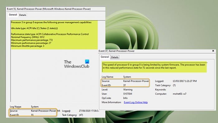

Reports have been that after upgrading/updating Windows 11/10, every time the PC restarts or boots the Event ID 55 (Kernel-Processor-Power) error pops up. In other reports, the hard drive automatically powers off after a couple of minutes of gameplay, and the game may stutter and lag and the event is logged in Event Viewer. This error can be logged with Event ID 35 in some cases. The solutions provided in this post still apply in both cases.
When this event is triggered and logged in Event Viewer, under the General tab, you may see a description along the following similar lines:
Processor 0 in group 0 exposes the following power management capabilities:
Idle state type: ACPI Idle (C) States (2 state(s))
Performance state type: ACPI Collaborative Processor Performance Control
Nominal Frequency (MHz): 3312
Maximum performance percentage: 772
Minimum performance percentage: 24
Minimum throttle percentage: 3Event ID: 55
Investigations revealed that this event is related to the power management of the processor on your computer. The event is generated when the system experiences an issue with the power management of the processor. This could be caused by a variety of factors, including hardware issues, driver issues, or problems with the power settings on your computer.
Fix Event ID 55 or 37 (Kernel-Processor-Power) error
If the Event ID 55 or 35 (Kernel-Processor-Power) error is being logged in Event Viewer on your Windows 11/10 PC after exhibiting unusual behavior like the hard disk automatically shutting down when in use after a couple of minutes, then our suggested fixes presented below can be applied to resolve the issue.
