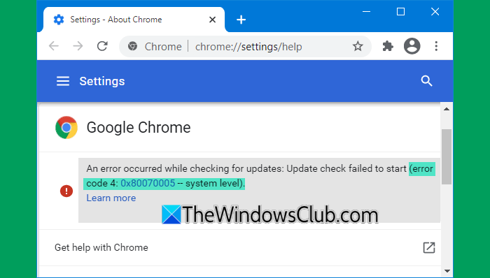

When we access the About page of Google Chrome, it automatically checks for updates, downloads them, and installs them. But, a lot of users have faced Error code 4: 0x80070005 – System Level issue when updating the Chrome browser. If you are also facing this issue, then you can try some fixes covered in this post.
The error message goes like this:
An error occurred while checking for updates: Update check failed to start (error code 4: 0x80070005 – system level)

Chrome Error code 4: 0x80070005 – System Level
Here are the solutions to this vexing problem:

2] Start Google Update services
This is most likely the reason behind error code 4: 0x80070005 – system level. Google Update services should be run automatically or manually. If it is stopped or disabled, then you will see this error while updating the Chrome browser. So, you need to enable or start Google Update services. A lot of users have benefitted from this fix.
First of all, close the Chrome browser if it is running already.
After that, open Windows Services manager using Run Command (Win+R) or Search box. You will see a list of all the services (running or stopped). Scroll down and look for Google Update Service (gupdate). Double-click on it.
Check the Service status. If it is stopped, press the Start button. It will take a few seconds and service will be started. Also, set the service Startup type to Automatic or manual. Press Apply and OK buttons.
Do the same for Google Update Service (gupdate). This service is available just below the above-mentioned service.
Now open Google Chrome and access the About page. Now it should automatically check for updates and install them.
