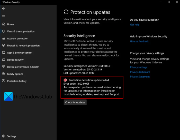

If Windows Security (Microsoft Defender) throws Error 8024402f, Protection definition update failed on Windows 11, then follow this post to successfully fix the issue. Several users have complained of receiving the error code 8024402f while installing security signatures updates on Windows Security or Windows Denedfer.
When triggered, you will most likely see the following error message on Windows Security:
Protection definition update failed.
Error code: 8024402f
An unexpected problem occurred while checking for updates. For information on installing or troubleshooting updates, see Help and Support.
This error seems to be exclusive to Windows 11, so don’t confuse it with the generic 8024402f error code that occurs on older versions of Windows.
