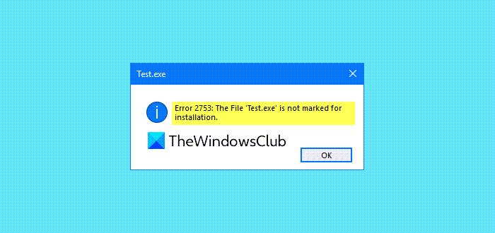

When you try to install any program on your Windows 11/10 computer, you might get an Error 2753. Sometimes, the packages are corrupt, or maybe those packages are not working properly or are not able to create files and paths. One such annoying error reads – Error 2753, The File is not marked for installation.
This error is not limited to specific files. It can happen with any file, whether an executable file or an MSI file. Let’s see how to fix this error.
Error 2753, The file is not marked for installation
