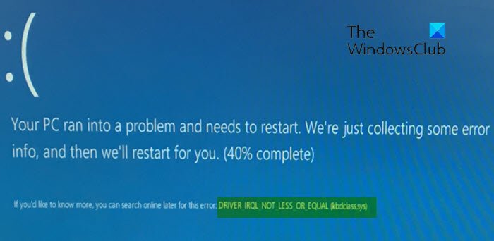

Some PC users are experiencing an unusual issue with wireless keyboards, namely Microsoft wireless keyboards, whereby when they plug in a standard corded USB keyboard they can use the Windows 11/10 computer, but the moment the wireless is plugged in, and they push any key on the keyboard, the computer crashes and throws the DRIVER IRQL NOT LESS OR EQUAL (kbdclass.sys) Blue Screen of Death error. This post provides the most suitable solutions to this issue.
KBDCLASS.SYS is a Keyboard Class, which is classified as a driver. It’s responsible for the generic settings within a keyboard – this driver handles all keyboard key combinations as well as all single key you tap on the keyboard.
All Windows classes have particular codes assigned to them. If the class that is being issued is not a system file, then you may not experience problems. However, in this particular case, the .sys file is a system file. Therefore, if the code of this class gets altered in any way, the KBDCLASS.SYS will crash, consequently triggering the BSOD error and other problems.
DRIVER_IRQL_NOT_LESS_OR_EQUAL (kbdclass.sys) BSOD

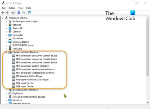

3] Rollback keyboard driver
If Windows has automatically installed an update for your HID Keyboard Device and the automatic update altered the keyboard class code this could make the error appear.
In this case, you can rollback the HID Keyboard driver under the Human Interface Devices section in Device Manager, and see if that helps.

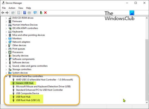

4] Reinstall USB Controllers
To reinstall USB Controllers, you have to uninstall them first. After that, restart the system and the controllers will be reinstalled automatically. To uninstall USB controllers, do the following:
- Press Windows key + X to open the Power User Menu.
- Press M key on the keyboard to open Device Manager.
- Once you’re inside Device Manager, scroll down through the list of installed devices.
- Expand the Universal Serial BUS Controllers section.
- Right-click on Generic USB Hub and select Uninstall device.
- Do the same for any USB Root Hubs entry.
- Restart your computer when done.
The issue should be resolved now. If not, proceed with the next solution.
