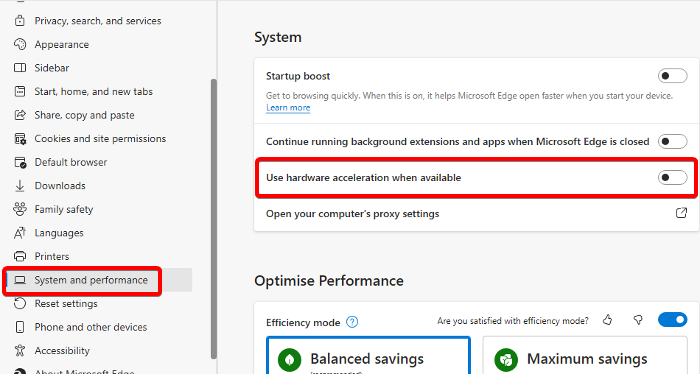

2] Disable Hardware acceleration
While Hardware Acceleration is meant to help your browser function better and faster for a certain task using the computer’s hardware, it can sometimes slow down the overall performance. Since Hardware Acceleration is enabled by default in browsers, including Edge, you can turn it off and check if it helps you get back the Modify button.
So, to disable hardware acceleration in Edge, launch the browser, click on the three dots on the top right (Settings and more), and click on Settings.
In the Settings window, click on System and Performance on the left. Now, navigate to the right, look for Use hardware acceleration when available, and turn it off.

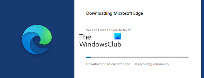

4] Reinstall Edge
Download Edge from microsoft.com and then run the installer to reinstall Edge. If you do not have any other browser installed, you can download Chrome and use it to download Edge.

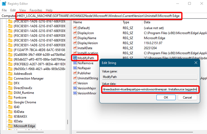

5] Edit the registry settings
If you are unable to uninstall Microsoft Edge following the above method and the Modify button is still greyed out and it’s not working, you can edit the registry settings. However, before you make any changes to the registry settings, make sure you backup the registry.
Now, open the Registry Editor, and navigate to the below path:
HKEY_LOCAL_MACHINE\SOFTWARE\WOW6432Node\Microsoft\Windows\CurrentVersion\Uninstall\Microsoft Edge
Now, on the right, look for the String Value, that is, ModifyPath.
But, if you do not find the String Value, right-click on a space, click on New, and then click on String Value. Now, rename this string as ModifyPath.
Next, double-click on this value to open the Edit String dialogue box. Here, copy and paste the below value in the Value data:
"C:\Program Files (x86)\Microsoft\EdgeUpdate\MicrosoftEdgeUpdate.exe" /install appguid={56EB18F8-B008-4CBD-B6D2-8C97FE7E9062}&appname=Microsoft%20Edge&needsadmin=true&repairtype=windowsonlinerepair /installsource taggedmi
Press OK to save the changes. Now, exit Registry Editor and restart your PC for the changes to be applied.
