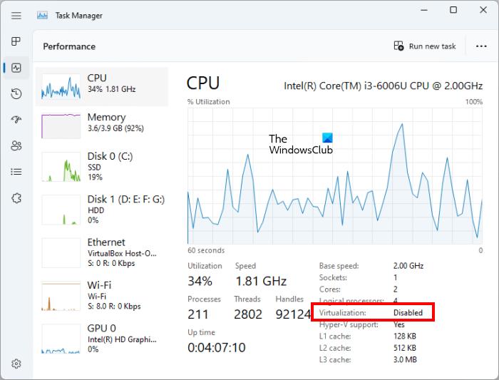

2] Toggle Virtualization on your system
BlueStacks require a hardware virtualization feature to run on Windows. If this feature is disabled on your system, you have to enable it. However, for some users, disabling Hardware Virtualization fixed the issue. You can check if this feature is enabled or disabled on your system by following the steps mentioned below:
- Open the Task Manager.
- Select the Performance tab.
- See if the Virtualization is enabled or disabled.
If Virtualization is enabled on your system, disable it. If it is disabled, enable it. Enabling or disabling Virtualization can help you fix the problem.

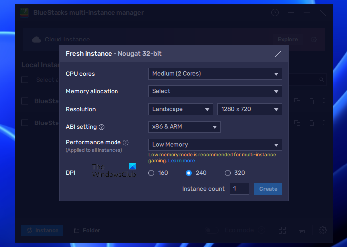

5] Install the 32-bit version of BlueStacks
If the error still persists, you can install the 32-bit version of BlueStacks. The 32-bit BlueStacks version also works on 64-bit Windows computers. Here is how to do that.
When you install BlueStacks, two additional apps also get installed automatically with the BlueStacks. These apps are BlueStacks X and BlueStacks Multi-Instance Manager. You have to use the BlueStacks Multi-Instance Manager to download and install the 32-bit version of BlueStacks. The following steps will guide you on this;
- Open the BlueStacks Multi-Instance Manager app.
- Click on the Instance button. You will find it on the bottom left side.
- Now, click Fresh Instance.
- Select Nougat 32-bit from the drop-down. Here Nougat is the Android version.
- Click Next and select CPU cores, Memory allocation, etc., depending on your system’s hardware. You should always allocate fewer CPU cores and less RAM to BlueStacks than your system has.
- When you are done, click Create.
After creating the new 32-bit instance of BlueStacks, you will be able to launch it from the BlueStacks Multi-Instance Manager (see the above screenshot). Click on the Start button to launch the 32-bit BlueStacks.
This should fix the issue.
