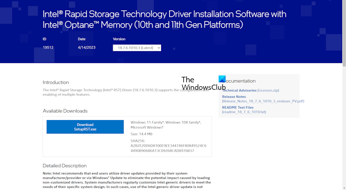

5] Uninstall and reinstall the Intel RST driver (if applicable)
The Intel RST (Rapid Storage Technology) on supported Windows computers manages the RAID Volumes and Intel Optane Memory Configuration. Check if your system has Intel RST.
First, create a system restore point. Now, open the Device Manager and expand the Storage Controllers branch. If you see the Intel Chipset SATA/PCIs RST Premium Controller driver there, right-click on it, and select Uninstall device.
Now, visit the official Intel Download Center website and download the latest version of the Intel RST driver. Install the driver. It will be available as the SetupRST.exe file.
