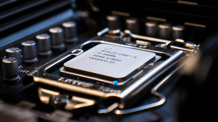

2] Check if any pins of your CPU are bent
It is possible that some of the CPU pins were bent during the installation process. If this happened, it might be the cause of the BSOD error. Check this. You have to open your computer case or laptop. If you find any CPU pins bent, fix them.

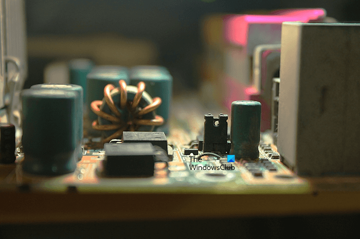

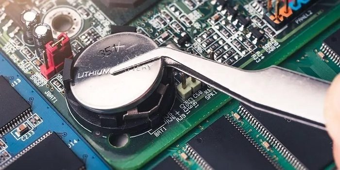

3] Clear CMOS
After installing new hardware, like a CPU or GPU, you should reset the BIOS settings to the default. If you have not done this yet, do it now. Clearing CMOS will also reset your BIOS settings to the default values.
First, turn off your computer and unplug the power cable to avoid electric shock. Now, locate the CMOS battery on the motherboard. It is a small coin-shaped battery. Remove it gently and wait for a few minutes. After that, reinstall the battery correctly. Now, turn on your computer and see if the Blue Screen error occurs.

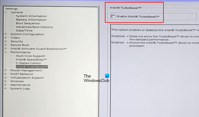

4] Disabled the Intel Turbo Boost option (if applicable)
Some CPUs have a Turbo Boost option. This feature can be enabled and disabled in BIOS. The Intel Turbo Boost option is available under the Performance section in BIOS. However, it may be different for laptops of different brands. You can check the supported Turbo Boost processors on the official Intel’s website.

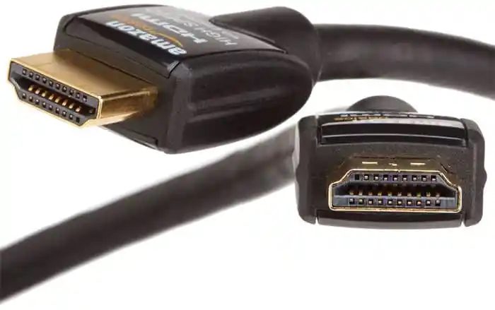

7] Change the HDMI or DisplayPort cable
The problem may also be associated with the cable used to connect your graphics card to your monitor. Use another cable and see if it helps. You can also replace the HDMI cable with the DisplayPort cable and vice versa (if applicable).

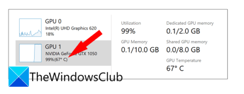

9] Check CPU and GPU temperature
High CPU or GPU temperature is one of the possible causes of the Blue Screen errors on a Windows computer. Monitor your CPU and GPU temperature. You can use the built-in tool, Task Manager to monitor your GPU temperature. or install third-party tools to monitor your CPU temperature and GPU temperature.
If you notice high CPU and GPU temperatures, first, you need to fix this. You can take some steps to lower your GPU temperature, like under-volting the GPU, disabling overclocking, etc. One more thing that you can do to reduce your CPU temperature is to lower the maximum processor state. Try this. If this causes issues, revert the changes.
