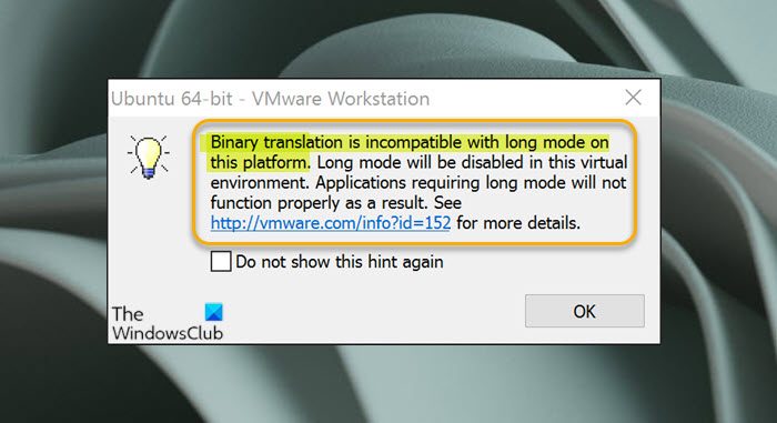

If you are receiving the error message Binary translation is incompatible with long mode on this platform when trying to open a virtual machine with VMware Workstation or when the Windows 11 or Windows 10 host machine goes into sleep mode, then this post is intended to help you with the most suitable solutions you can apply to resolve the issue.
Depending on the VM you’re trying to open, when you encounter this issue, you’ll receive the following full error message;
Ubuntu 64-bit – VMware Workstation
Binary translation is incompatible with long mode on this platform. Long mode will be disabled in this virtual environment. Applications requiring long mode will not function properly as a result. See http://vmware.com/info?id=152 for more details.

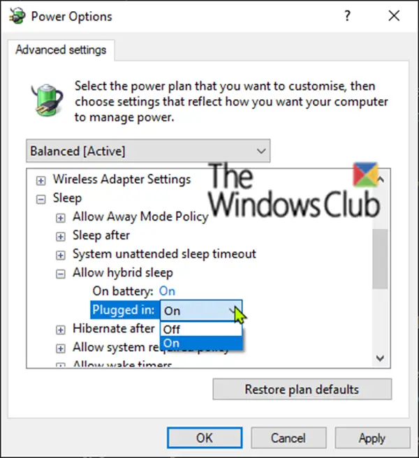

5] Disable Hybrid Sleep
Since you may encounter the error in view when the Windows 11/10 host machine goes into sleep mode, you can run the Power Troubleshooter to fix any power misconfigurations that might be triggering this error. Also, you can modify/change your Power Plan and as well disable Hybrid Sleep and see if that helps.
To disable Hybrid Sleep on Windows 11/10, do the following:
- Press Windows key + R. to invoke the Run dialog.
- In the Run dialog box, type control and hit Enter to open Control Panel.
- Click on Hardware and Sound.
- Select Power Options.
- Depending on your PC current power plan, click on Change plan settings.
- Choose Change advanced power settings.
- Now, click the + sign against Sleep, to expand the section.
- Click on Allow hybrid sleep and then set it to Off for both On battery and Plugged in option.
- Next, go to Hibernate after and then set it to Never for both On battery and Plugged in option.
- Click Apply > OK.
- Exit Control Panel.
