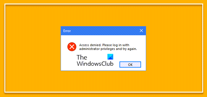

There may be instances when you have come across the error message that says “Access denied, Please log in with administrator privileges and try again” on your Windows system. It is bizarre how this message box pops up even when you are the administrator of your computer. This usually shows up when you try to open some particular program or game. It is mostly the older games and programs that are affected when you try to run them on Windows 11/10. If you face this issue, this post is sure to help you.
Before moving on to troubleshooting, first and foremost ensure that the program you’re running is compatible with your Windows version. If not fix this issue by using Windows Compatibility Troubleshooter and see if the problem is solved. If this fails, please proceed to the troubleshooting steps detailed below.
