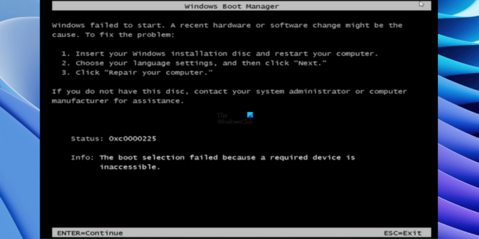

This article provides solutions to fix the “0xc0000225, Boot selection failed because a required device is inaccessible” error. You may see this error in any of the following scenarios:
- While upgrading your Windows operating system.
- While performing a clean installation of Windows OS.
- While installing Windows Updates.
- While turning on an Azure VM.
There could be multiple causes of this error. Here, we will also talk about some causes of this error.
Fix Boot selection failed because a required device is inaccessible, Error 0xc0000225
Use the following solutions to fix the “0xc0000225, Boot selection failed because a required device is inaccessible” error on your Windows computer.

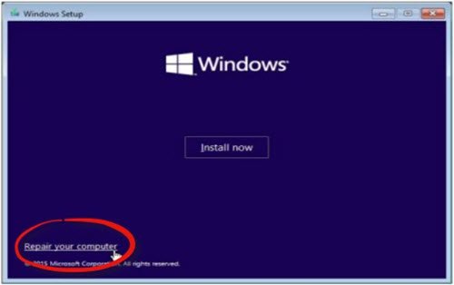

2] Run a Startup Repair
Startup Repair is used to repair corrupted files and Windows boot problems. Your computer is showing you the error message on boot. Hence, running the Startup repair may help. To run Startup Repair, you have to enter Windows Recovery Environment. To do so, press and hold the Shift key and then restart your computer. This will take you to Windows Recovery Environment.
If this does not work, you can enter Windows RE by interrupting the normal boot process. The following steps will guide you on this:
- Force shut down your computer by pressing and holding the power button.
- Wait for a few seconds and turn on your computer. When you see the Windows logo or your computer manufacturer’s logo, immediately press and hold the power button to force shut down your computer.
- Repeat the above steps three to four times. After that, Windows will automatically boot into Windows Recovery Environment.
After entering Windows Recovery Environment, go to “Troubleshoot > Advanced Options > Automatic Repair.” Let Windows repair your PC. After the completion of Automatic Repair, check if you can start your computer.
You can also use Installation Media to repair your computer.
