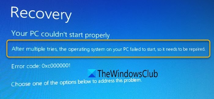

In this post, we will show you how to fix Diagnosing your PC, Your PC couldn’t start correctly, Error Code 0xc0000001 on Windows 11 or Windows 10 computer. This could occur due to various reasons, including a faulty driver or software, corruption in Boot Configuration Data file, etc. You can find all the solutions here in this article.
A required device isn’t connected or can’t be accessed
Error code: 0xc0000001
When it appears, it asks you to press Enter to try again to log in or F8 to find an alternate boot option. It would be best to try pressing the Enter button because the solution is much easier when you can sign in to your system. Next, press F8 and see if that helps. However, if you cannot log in to your computer, you can try the following suggestions.

After multiple retries, the operating system on your PC failed to start
If you receive After multiple retries, the operating system on your PC failed to start, Error 0xc0000001, press Esc to see the Recovery options and use one of them If that does not help, press F8 to access Startup Settings and then use the command prompt to run DISM Offline or uninstall and driver updates. If that does not help, you will have to repair Windows using the Installation Media as explained in this post.
