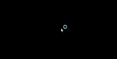

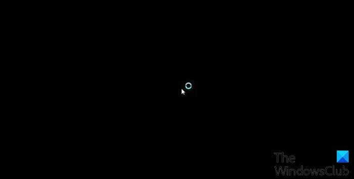

There might be an instance where after a power outage, your Windows system won’t be able to boot. In this case, any attempt to boot the system would only take you to a loading screen.
Windows computer won’t boot after power outage
If your Windows 11/10 computer won’t boot after a power outage, here are some solutions that might help you fix the problem.
