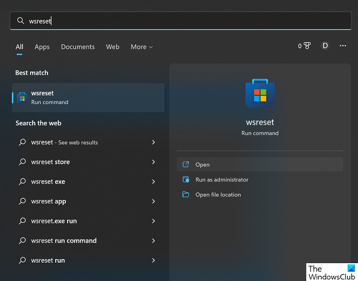

7] Clear Microsoft Store Cache
The “Xbox app not opening or working” problem could very well be facilitated due to a corrupted Microsoft Store cache. Hence, if the scenario is applicable, reset the Microsoft Store cache and check if the problem is gone or not.
To clear the Microsoft Store cache, you can follow the below steps:
- First, type WSReset in the Start menu search box.
- Now, click on the WSReset command to run it. It will then clear all the cache associated with Microsoft Store.
- You can now try launching the Xbox app and check if it works fine or not.
