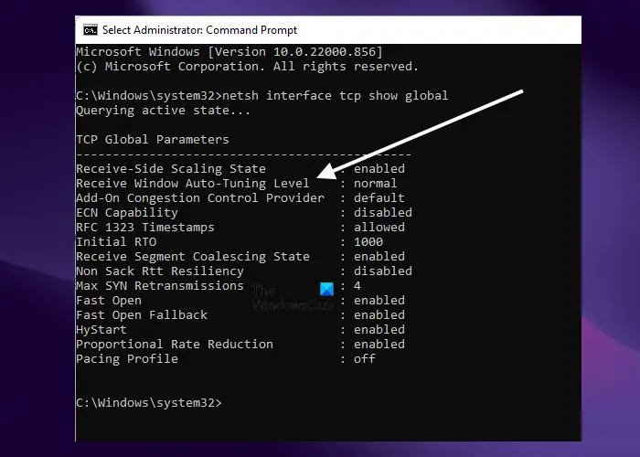

4] Check the status of the Receive Window Auto-Tuning Level
The Receive Window Auto-Tuning Level is a feature that improves performance for programs that receive TCP data over a network. This feature is disabled by default for the programs that use the Windows HTTP Services (WinHTTP) interface. Some examples of programs that use WinHTTP include Remote Desktop Connection and Windows Update. Enabling the Receive Window Auto-Tuning Level feature will make your network connection more efficient by increasing the data transfer rates.
Check the status of the Receive Window Auto-Tuning Level. If you find it disabled, enable it. The following instructions will help you with that:
Open the Command Prompt as an administrator. Copy the following command, paste it into the Command Prompt (Admin), and press Enter.
netsh interface tcp show global
If the status of the Receive Window Auto-Tuning Level shows disabled, you have to enable it. To do so, copy the following command, paste it into the Command Prompt (Admin), and press Enter.
netsh int tcp set global autotuninglevel=normal
This solution has fixed the issue for many users. It should also work for you.

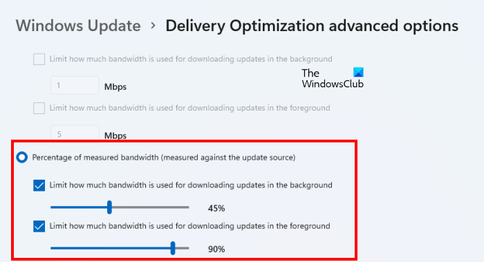

8] Change the Delivery Optimization Advanced Settings
The Delivery Optimization Advanced Settings on Windows 11/10 lets you set the percentage of measured bandwidth for downloading the updates in the foreground and background. Changing this setting may boost your downloading speed on Xbox. The following steps will help you with that:
- Click on the Windows Search and type delivery optimization advanced settings.
- Select the desired option from the search results.
- By default, the Absolute bandwidth option is selected. Select the second option (Percentage of measured bandwidth).
- Select both checkboxes and move the slider to limit the bandwidth. For some users, limiting the bandwidth to 100% fixed the issue.
Now, open Xbox app and see if the download speed increased.
