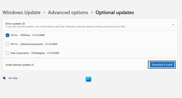

2] Update Device Drivers
Outdated or corrupted drivers can also be responsible for why wireless networks are not working on Surface. Update your Surface drivers and check if the issue gets fixed. Here’s how you can do it:
- Open Settings and navigate to Settings > Update & Security > Windows Update.
- Right under it, look for a clickable link— View optional updates.
- Under Driver Updates, a list of updates will be available, which you can choose to install if you are facing an issue manually.

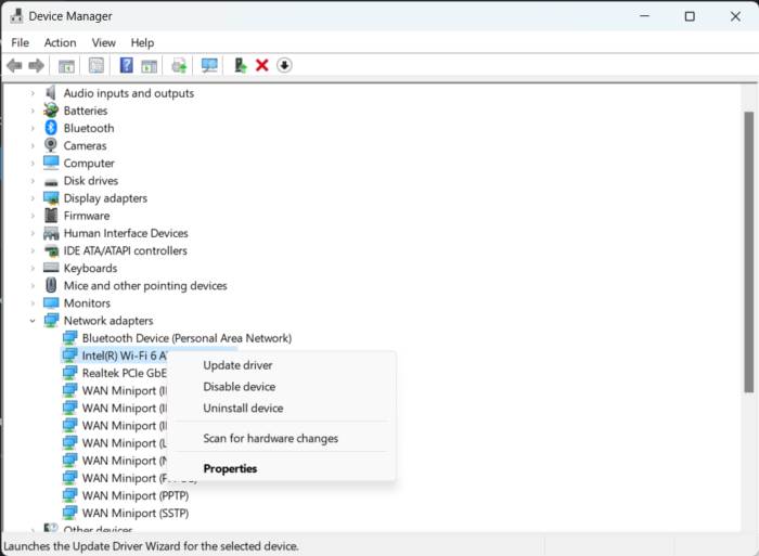

7] Check if Wi-Fi is present in Device Manager
Wireless networks can stop working if they get disabled in the Device Manager. Here is how you can check for the same:
- Click on the Windows key + R to open the Run dialog box.
- Type devmgmt.msc and hit Enter.
- Scroll down and expand Network Adapters.
- Right-click on your adapter and select Enable.
