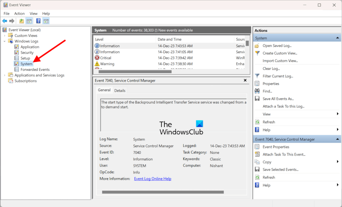

5] Check Event logs
Whenever a problem occurs on a Windows computer, Windows writes it in a log file. These log files are available in Windows Event Viewer and give information about the errors. I suggest you check Windows Event Viewer for more details about the problem.
For example, the “Event ID 41, System has rebooted without cleanly shutting down first” is associated with bad RAM. However, other hardware issues are also responsible for this error, such as a faulty power supply or overheating. In this case, you need to test your RAM health.
