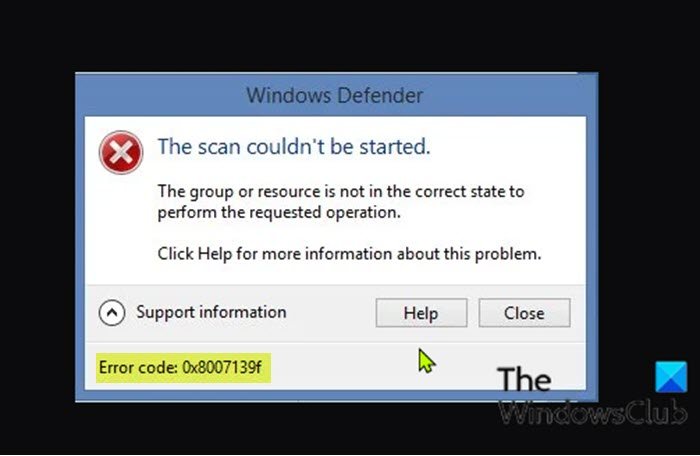

If when you attempt to run a Microsoft Defender scan on your Windows 11 or Windows 10 device, but the AV scan fails and you receive the error code 0x8007139f, then this post is intended to help you with solutions to resolve the issue.
When you encounter this issue, you’ll receive the following full error message;
Windows Defender
The scan couldn’t be started.
The group or resource is not in the correct state to perform the requested operation.
Click Help for more information about this problem.
Error code: 0x8007139f
Similarly, you may get the error message below instead, when you encounter this issue.
Windows Defender
The service couldn’t be started.
You’ll encounter this error due to Windows Defender conflict with third-party security software installed on your Windows PC. Corrupt system files could also trigger this error.

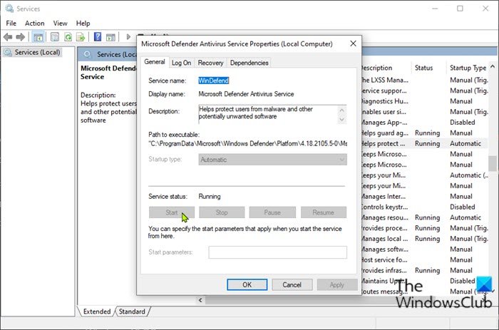

3] Check Windows Defender Service
This solution requires you to check if the Windows Defender Service is running on your Windows device. Here’s how:
- In the Run dialog box, type services.msc and hit Enter to open Services.
- In the Services window, scroll and locate the Microsoft Defender Antivirus Service.
- Double-click on the entry to edit its properties.
- If the service is stopped, click the Start button. If it doesn’t get started, then just make sure that the option under the Startup type menu in the service’s properties window is set to Automatic. Confirm any dialog boxes which may appear when changing the startup type.
- Exit Services console.
- Restart your PC.
On boot, run the scan again. If the issue is still unresolved, try the next solution.
