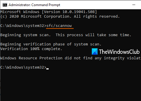

1] Run SFC scan
The Windows Defender Error 1297 that is triggered on your Windows 11/10 PC could be due to corrupted system files. In this case, you can begin troubleshooting by running SFC scan on your device and see if that resolves the issue.
The sfc /scannow command will scan all protected system files, and replace corrupted files with a cached copy that is located in a compressed folder at %WinDir%\System32\dllcache. In most cases, if some Windows functions aren’t working or Windows crashes, use the System File Checker to scan Windows and restore your files.
