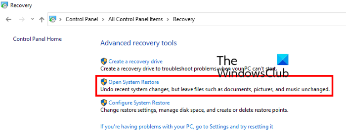

3] Perform a System Restore and then install the Graphics driver
Some users have installed the Graphics driver after performing the System Restore. You can also try this method. System Restore is a tool developed by Microsoft that repairs the corrupted software. In case of data corruption or installation failure, the System Restore takes the system to a previous working condition without reinstalling the operating system.
The following steps will help you restore your system to a previous state:
- Press the Win + R keys and type Control Panel. After that hit Enter. This will launch the Control Panel.
- Now, in the Control Panel, click on the search box at the top right side and type Recovery.
- Click Recovery from the results.
- Now, click Open System Restore.
- In the System Restore Window, select either the Recommended restore or Choose a different restore point option. The latter option will be available only if you have created a system restore point previously.
- Click Next and follow the on-screen instructions.
It will take time to restore the system to the previous state. Therefore, you have to keep patience.
After the System Restore is completed, check if you can install the driver or not.
