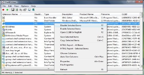

Installed Add-ons are usually the culprit! Check if you have installed any helpers or add-ons to your explorer. Uninstall or disable them. Often, even 3rd-party shell extensions can cause Explorer to crash on particular actions. Several programs add items to the right-click context menu. To see them in detail, you may download the freeware utility Nirsoft ShellExView.
It will let you view and disable suspect third-party shell extensions. Using the trial & error method, you may disable/enable the extensions to try and identify if any of them are causing a problem. ShellExView can also be used to solve context-menu problems in Explorer, such as when the right-click is slow.

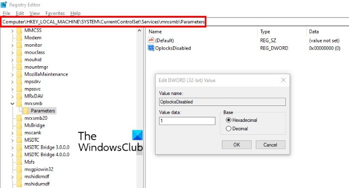

2] Disable Opportunistic Locking
An Opportunistic Lock a.k.a., oplock is placed by a client on the file located on the server. By making the oplock request, the client can cache data locally. This decreases the network traffic and improves the apparent response time. The oplocks can be used on the clients with remote as well as local servers. The server response to open the files with opportunistic locking enabled depends on the type of oplock.
To solve the system lagging issue while working with the files located on servers, you can disable the opportunistic locking on the client or the server.
The below process will guide you on how to disable the opportunistic locking on the client:
Launch the Registry Editor and navigate to the following path:
HKEY_LOCAL_MACHINE\System\CurrentControlSet\Services\MRXSmb
Expand the mrxsmb key and select the Parameters subkey. If the subkey is not there, you have to create it. For this, right-click on the mrxsmb key and go to “New > Key.” Name the newly created subkey as Parameters. Now, select the Parameters subkey and select the OplocksDisabled value on the right side. If the value is not there, create it. For this, right-click on the empty space on the right pane and go to “New > DWORD (32-bit) Value.” Name this value as OplocksDisabled.
Now, double click on the OplocksDisabled value and change its Value data from 0 to 1.
