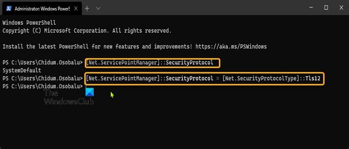

- In the PowerShell console, type or copy and paste in the command below and hit Enter to display a list of protocols used for connection:
[Net.ServicePointManager]::SecurityProtocol
As already mentioned, Microsoft repository requires TLS 1.2 or TLS 1.3 from Windows 11/10 client machines; so if the output shows PowerShell is using legacy SSL 3.0, TLS 1.0, or TLS 1.1, you can now run the command below to set PowerShell to use TLS1.2 or newer:
[Net.ServicePointManager]::SecurityProtocol = [Net.SecurityProtocolType]::Tls12
Once done, you can install a PowerShell module using the Install-Module without issues.
