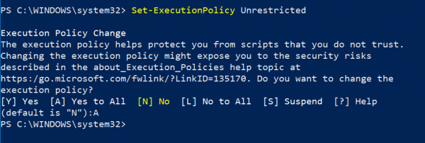

1] Set Execution Policy to Unrestricted
Most affected users were able to resolve the Install-Module command was found in the module PowerShellGet but the module could not be loaded error that occurred on their Windows 11/10 PC by simply setting ExecutionPolicy to unrestricted. To perform this task, you can follow the instructions in the guide on how to fix PowerShell cannot be loaded because running scripts is disabled.
