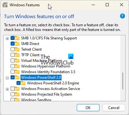

1] Disable and Re-enable Windows PowerShell
Open Control Panel > Turn Windows features on or off and locate Windows PowerShell in the Windows Features box.
Uncheck it, click OK and restart your computer.
Then again, open this box, select Windows PowerShell, click OK and restart your computer.
See if this has helped.
