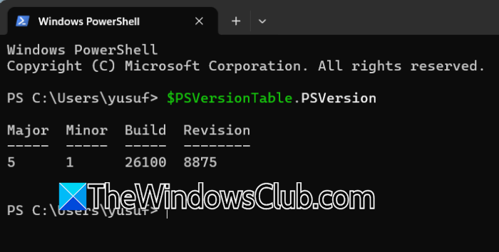

Additionally, PowerShell Direct requires PowerShell 5.0 or later. Run this command on the Hyper-V host to check your PowerShell version.
$PSVersionTable.PSVersion
If the host or guest does not meet the requirements, update the operating system or use another method to connect to the VM.

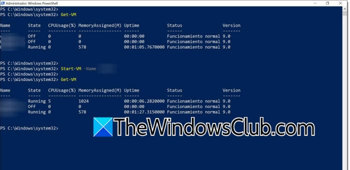

3] Make sure the virtual machine is running
PowerShell Direct cannot connect to a VM that is turned off or has not finished booting.
Now run the following command on the Hyper-V host.
Get-VM
Look at the State column. It should show Running for the VM you want to access.
If it is off, start it with the following command.
Start-VM -Name "VMName"
Then wait for Windows to finish booting and try this command.
Enter-PSSession -VMName "VMName" -Credential (Get-Credential)
