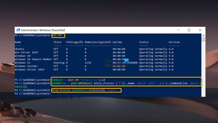

1] Stop an unresponsive Hyper-V VM using PowerShell
- Open PowerShell in admin mode.
- Type the command below and hit Enter to get an output of all your VM’s GUID. You will need to know the name of the unresponsive VM.
Get-VM
- Once you have the VM name, run the command below. Substitute the VM_NAME placeholder with the name of the VM you want to stop:
$VmGUID = (Get-VM 'VM_NAME').id
- Next, run the command below to find the process ID of the VM. The command uses the Win32_Process Windows Management Instrumentation (WMI) namespace to find a running CPU process that matches vmwp.exe and the GUID ($VmGUID) of your virtual machine.
$VMWMProc = (Get-WMIObject Win32_Process | ? {$_.Name -match 'VMWP' -and $_.CommandLine -match $VmGUID})
- Once we have the process ID ($VMWMProc), you can run the Stop-Process cmdlet as shown below to kill the process:
Stop-Process ($VMWMProc.ProcessId) –Force

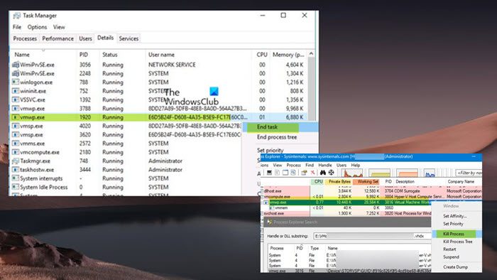

2] Stop an unresponsive Hyper-V VM using Task Manager or Process Explorer
All VMs on a Hyper-V host is started using the Virtual Machine Worker Process vmwp.exe process instances that you will have to kill if a VM is stuck. To find a specific process PID, you need to find out the GUID of the virtual machine.
For either of these methods, you can get the VM GUID using the Hyper-V Manager console.
- Open the Hyper-V server settings.
- The Server section contains the directory where the VM configuration files are stored.
- Once you have identified the folder, navigate to the directory in File Explorer.
- At the location, find the folder with the name of your stuck virtual machine.
- Copy the GUID that is specified in the name of the VM configuration file with the
*.vmcxextension. - Next, open Task Manager and go to the Details tab.
- Now, in the User name column, find and kill the process vmwp.exe that has the GUID of your VM that is stuck.
Similarly, you can the Process Explorer tool to find and stop a stuck virtual machine process on a Hyper-V host by following these steps:
- Run Process Explorer as administrator.
- Next, press the Ctrl-F key combo or click Find Handle or DLL.
- Specify the path to the virtual disk (*.vhdx) of the Hyper-V VM that is stuck in the starting/stopping state.
- Process Explorer will list all processes using the virtual machine VHDX file.
- Now, locate the vmwp.exe virtual machine process.
- Right-click the process and select Kill Process from the menu.
