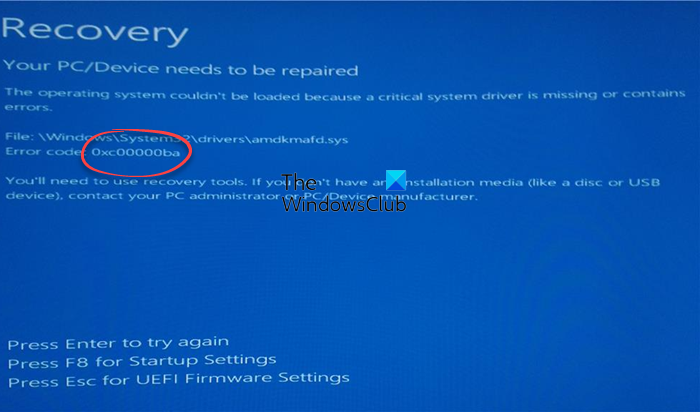

The operating system couldn’t be loaded because a critical system driver is missing or contains errors, Error code 0xc0000221 or 0xc00000ba message appears if the system is unable to boot normally. One such file that can cause this error is qevbda.sys, amdkmafd.sys, etc. The qevbda.sys file is located in \%Windir%\%System%\drivers\, and it’s associated with the product QLogic FastLinQ Ethernet manufactured by Cavium, Inc/QLogic Corporation. The amdkmafd.sys file belongs to the AMD driver. This post provides the most suitable solutions you can try to successfully fix the boot time error in Windows 11/10.
The operating system couldn’t be loaded because a critical system driver is missing or contains errors, Error 0xc0000221 or 0xc00000ba
If you see error codes 0xc0000221 or 0xc00000ba, for system driver files like qevbda.sys, amdkmafd.sys, etc., you can try our recommended solutions below in no particular order and see if that helps to resolve the issue.
