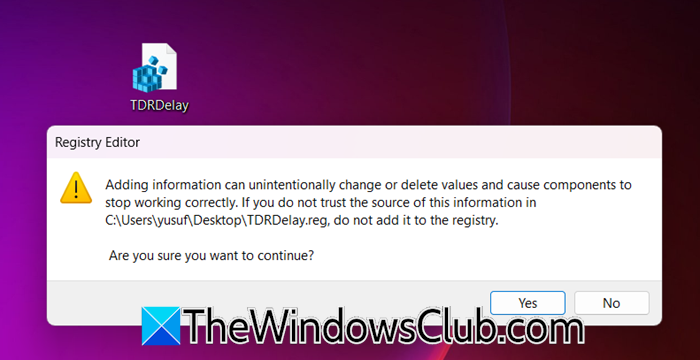

3] Edit Timeout Detection and Recovery (TDR)
In this solution, we are going to make some changes to the registry. However, before that, create a backup of the registry. This can be used if things go south. After creating the backup, you need to open Notepad and paste the following line of text.
Windows Registry Editor Version 5.00 [HKEY_LOCAL_MACHINE\SYSTEM\ControlSet001\Control\GraphicsDrivers] "TdrDelay"=dword:00000064
Give it a name like TDRDelay.reg. Make sure to add .reg extension.
Once done, double-click on .reg, you will be asked for confirmation, click Yes when prompted.
This registry entry modifies the Timeout Detection and Recovery (TDR) setting for your graphics drivers. TDR is a Windows mechanism that monitors the GPU for responsiveness; if the GPU fails to respond within a set time, Windows resets the display driver to prevent system crashes.

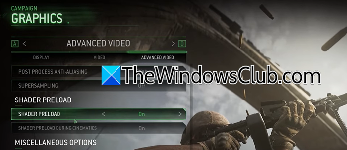

4] Make changes to Modern Warfare Settings
If you were specifically having issues with Modern Warfare, you need to make changes to the game’s settings and lower the resource consumption. After analyzing for a bit, we noticed that the game doesn’t just crash during startup; it crashes when one tries to play a game. Therefore, we are good to make the needful changes. So, open the game and go to Options > Graphics. Then, you need to disable Shader Preload and Shader Preload during Cinematics. Finally, save the game and start playing.
