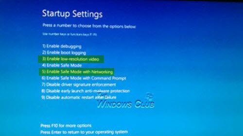

1] Enable Safe Mode with Networking or Enable low-resolution video
This solution requires you to access Advanced Startup options > Troubleshoot > Advanced options > Startup Settings options and select either Enable Safe Mode with Networking or Enable low-resolution video and see if the ks.sys BSOD error will be resolved on next startup.
