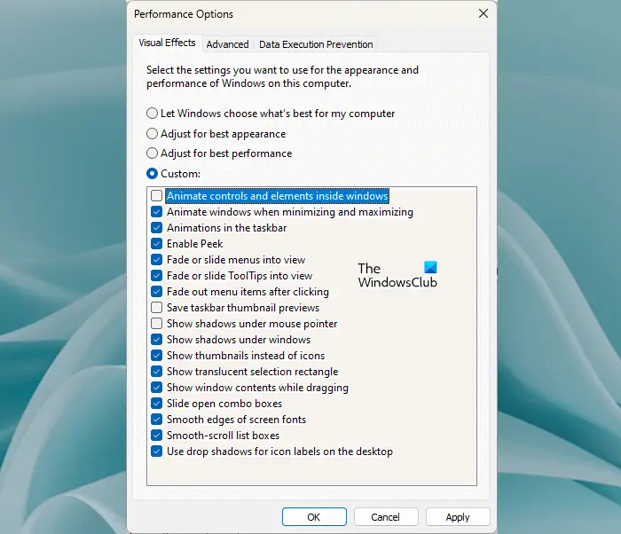

3] Change Performance Options
Some users were able to fix the issue by changing the Performance Options. You should also try this. Go through the following instructions:
- Open Windows 11/10 Settings.
- Go to System > About.
- Click on the Advanced System Settings link.
- The System Properties window will appear. Now, go to the Advanced tab.
- Under the Performance section, click Settings. This will open the Performance Options window.
- Uncheck the Animate controls and elements inside windows checkbox.
Now, see if the problem is fixed. If not, use other solutions.
