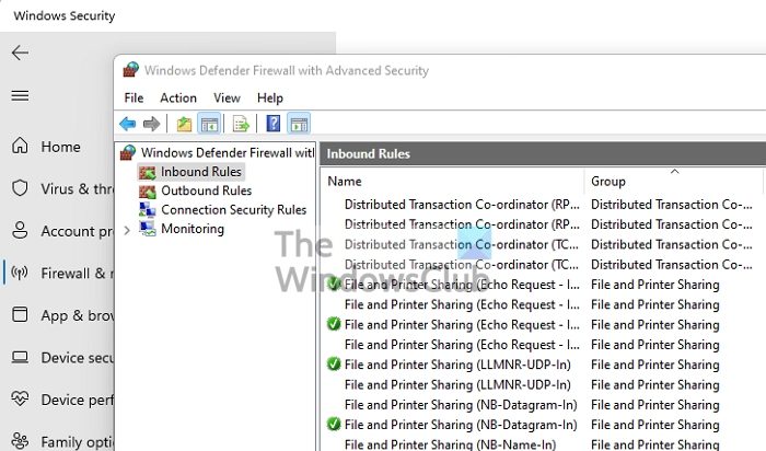

2] Temporarily Disable Firewall
At times, the Security software on your PC or the Windows Firewall could be blocking the shared printer.
Check InBound and Outbound Rules
- Open Windows Security
- Go to Firewall and network protection
- Click on the Advanced Settings link to open Windows Defender Firewall with Advanced Security.
- Click on Inbound Rules to view a list of inbound rules
- Locate rules related to File and Printer sharing
- Please enable it.

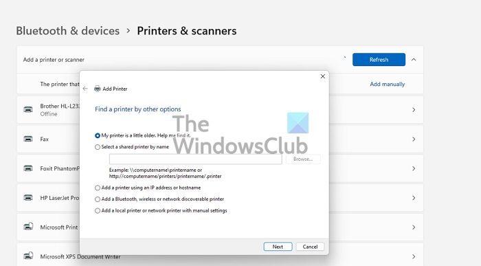

3] Reshare Printer and Add Printer again
It would work out great to ask the person who shared the printer to do it again. It is possible because of some misconfiguration from the other end. The printer sharing is not working as expected.
If not, you can remove the printer (if visible) and add it again. When doing so, if the OS asks you to install the printer driver, then make sure to do that too.
Go to Windows Settings > Bluetooth & devices > Printers and scanners > Add device. If the printer is available, then it will find it automatically. If not, you can add the printer manually.
