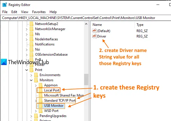

1] Add standard print monitor keys and their values
Carefully follow all the steps:
- Launch or open Registry Editor of Windows 10
- Access Monitors registry key. The path is:
HKEY_LOCAL_MACHINE\SYSTEM\CurrentControlSet\Control\Print\Monitors
- Create Local Port, Standard TCP/IP Port, and USB Monitor registry keys under Monitors key
- Create Driver name String Value in all the above-mentioned registry keys
- Double-click on Driver value for Local Port key
- Add localspl.dll in the Value data box
- Press OK
- Double-click on Drive String value for Standard TCP/IP Port key
- Add tcpmon.dll in Value data box
- Press OK
- Double-click on Driver value for USB Monitor key
- Add usbmon.dll in Value data box
- Press OK.

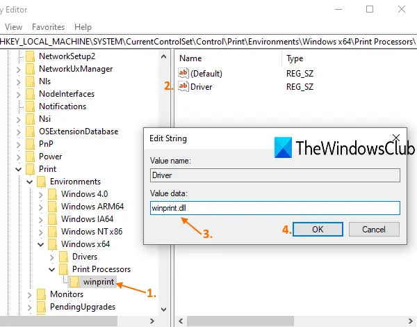

2] Add winprint Registry key and its String Value
- Open Windows 10 Registry Editor
- Access Print Processors key. The path is:
HKEY_LOCAL_MACHINE\SYSTEM\CurrentControlSet\Control\Print\Environments\Windows x64\Print Processors
- Create a winprint Registry key under the Print Processors key
- Create Driver name String Value on the right-hand side
- Double-click on Drive String Value
- Add winprint.dll entry in the Value data field
- Press OK.

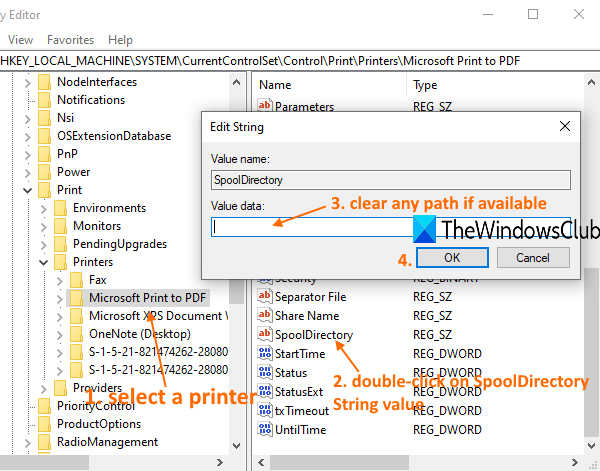

3] Delete any fake path for SpoolDirectory String Value of your printer
This option might help if you have connected multiple printers with your computer. Some infectious files or malware might have added some fake path in the Value data field of SpoolDirectory String Value of your printer present in the Registry Editor. That might be causing an obstacle in using Print Spooler perfectly. So, deleting that fake path might help. The steps are:
- Open Registry Editor
- Access Printers Here is the path:
HKEY_LOCAL_MACHINE\SYSTEM\CurrentControlSet\Control\Print\Printers
- Under Printers, click on the Printer name that is causing the problem
- On the right-hand side, scroll down and double-click on the SpoolDirectory String value
- Clear or remove all the entries present in the Value data field
- Press the OK button.
