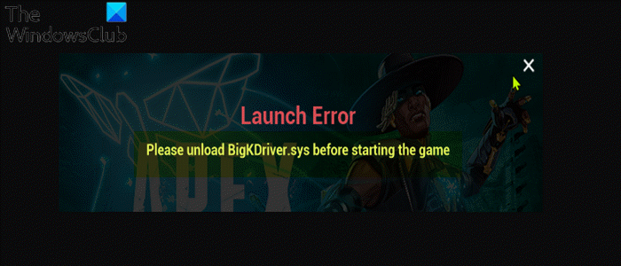

Some PC gamers when attempting to start a game on their Windows 11 or Windows 10 computer, reported they encounter the error message Please unload BigKDriver.sys (helpsrv.sys, p.sys, iusb3hcs.sys, amdxhc.sys, etc) before starting the game. This post is intended to help affected users resolve this issue. Remember that there are various instances of this error, the common element being that the game asks you to unload a sys driver file.
What is BigKDriver.sys?
BigKDriver.sys is a system file associated with Easy Anti-Cheat. Most Windows system files are stored in C:\Windows, especially in /System32 and /SysWOW64 subfolders. But, you’ll also find system files spread across user folders (like the Appdata folder) and app folders (like ProgramData or the Program Files folders).

Please unload helpsrv.sys, p.sys, iusb3hcs.sys, amdxhc.sys or BigKDriver.sys before starting the game
If a game asks you to unload a sys driver file on your Windows 11/10 gaming rig, you can try our recommended solutions below in no particular order and see if that helps to resolve the issue. The file could be any like – BigKDriver.sys, helpsrv.sys, p.sys, iusb3hcs.sys, amdxhc.sys, etc.
