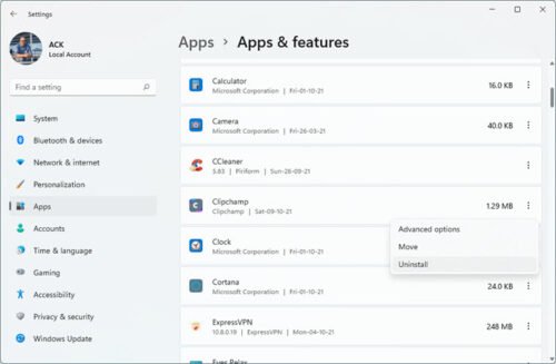

4] Uninstall and reinstall GeForce Experience
This solution requires you to uninstall the GeForce Experience app via Settings app or Programs and Features in Control Panel, restart your PC, then download the latest version of the app from the NVIDIA official website at nvidia.com/en-in/geforce/ and install on your Windows 11/10 PC. After the installation, you may have to restart the system. You should now be able to use the Share feature without issues.
