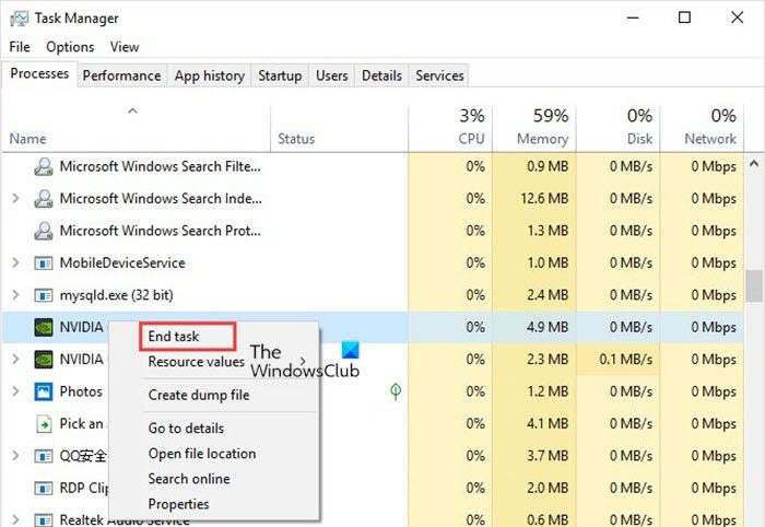

3] Restart the NVIDIA Control Panel process in Task Manager
It’s possible the issue you are currently facing has to do with a buggy NVIDIA Control Panel or the app is experiencing a temporary glitch. In this case, to see if the issue will be resolved, you can restart the NVIDIA Control Panel process in Task Manager. To perform this task, do the following:
- Press Ctrl + Shift + Esc key combo to open Task Manager.
- Click the Processes tab.
- Scroll down and right-click on the NVIDIA Control Panel.
- Select End task.
- Relaunch the NVIDIA Control Panel.
Other settings apart from the 3D Settings panel should now be showing and accessible.
