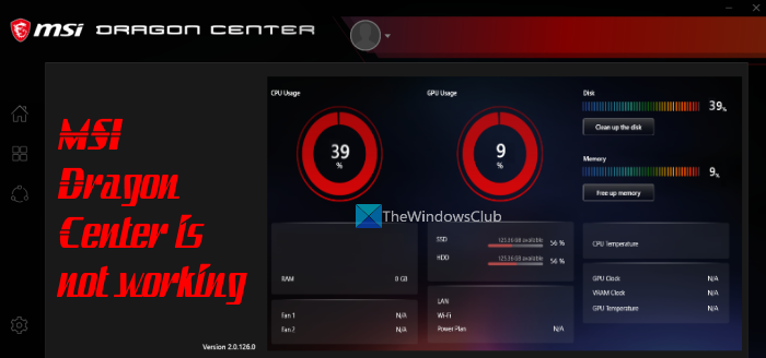

If MSI Dragon Center is not opening or working on your Windows 11/10 laptop/desktop, then this post can help you fix this problem. Users have reported that MSI Dragon Center was working fine but started causing issues like the interface being stuck on Wait for SDK loading screen, Load modules, etc. This issue might have started after a Windows Update or if a Service related to MSI Dragon Center is not running. Keeping the possible causes, we have created a list of solutions to help you make MSI Dragon Center work properly.
You can try the following solutions if MSI Dragon Center is not opening or working in your Windows 11/10 system:
