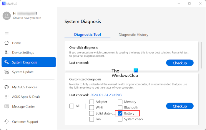

Some software have a feature to test the charger brick. For example, the MyASUS app developed by ASUS for ASUS computers has this feature. If you have an ASUS laptop, you can use that app to test your charger brick. To do so, follow the steps provided below:
- Open the MyASUS app.
- Select System Diagnostics.
- Select the Adapter checkbox.
- Connect your charger and turn on the power supply.
- Click on the Checkup button.
3] Run a battery test
We also suggest you run a battery test. This process will let you know whether the problem is with your battery or not. You can use free battery test software to test the health of your battery.
You can also use the dedicated software developed by your laptop manufacturer to test the health of your laptop battery. Some popular software are:
If you do not want to install third-party software, you can use the Command Prompt to generate your battery report. Or, you can also try one thing. Turn off your laptop and remove its battery. Now, plug in the charger and turn on the power supply. Turn on your laptop. Your charger is now providing continuous power to your laptop. See what happens to your mouse cursor. If the mouse works fine, your battery may be faulty. But do not jump to conclusions before trying other fixes.
