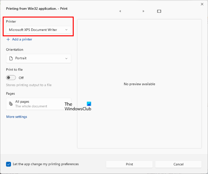

2] Try to print via Microsoft XPS Document Writer
Microsoft XPS Document Writer is a print-to-file driver that lets users create XML document files. If the Microsoft IPP Class Drier is missing or producing monochrome prints of your documents, you can try one thing. Print your documents using the Microsoft XPS Document Writer.
When you print a document, Windows shows you an option to select the printer. Select Microsoft XPS Document Writer from the drop-down and then click on the Print button. After that, Windows will save your document in the Open XPS format. Now, you can print that document. The problem should not occur this time.

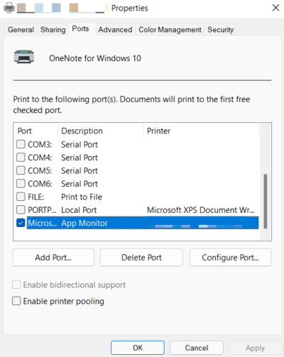

4] Select the correct printer driver and port
This solution has worked for many users. Select the correct printer driver and port for your printer and see if it fixes the problem. Follow the instructions written below:
- Open the Windows 11/10 Settings app.
- Go to “Bluetooth & Devices > Printers & Scanners.”
- Select the printer you are experiencing the problem with.
- Click on the Printer Properties option.
- A new window will open. Click on the Advanced tab.
- Click on the Diver drop-down menu and select the right printer.
- Now, click on the Ports tab and select the right printer.
- Click Apply and then OK.
Now, shut down your printer and restart your computer. After restarting your computer, turn on your printer and let it connect to your computer. You should be able to print in color using your printer.

6] Select the correct Printer name
If you don’t want to uninstall and reinstall the printer software, you can try changing the Ports settings. Here’s what you need to do.
- Open the Settings menu by pressing Windows + I shortcut key.
- Click on the Bluetooth & devices option present at the left final of the screen.
- Select the problematic Printer.
- In the following window, select Printer properties.
- Switch to the Ports tab.
- Checkmark the correct printer brand/ printer name.
- Click on Apply > OK.
That’s it. Now reboot the Printer and your Windows PC. Check if it solves the problem.

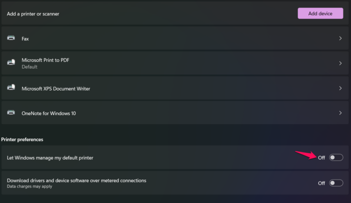

7] Disable Let Windows management default printer option
The next solution in the list is to disable the Let Windows manage the default printer option. You can disable it by following the below steps.
- Open the Settings menu, and navigate to Bluetooth & deceives > Printers & scanners.
- Under the Printers preferences, disable the toggle present next to Let Windows manage my default printer.
Now reboot the system and check whether the problem persists.

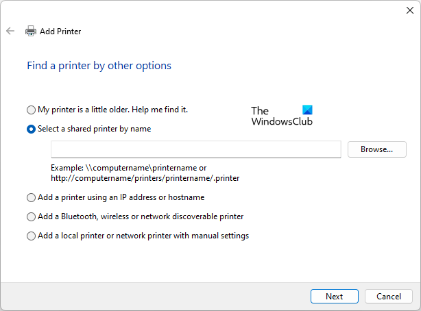

You can install the Microsoft IPP Class driver for your printer by following the steps listed below.
- Right-click on the Start menu and select Settings. This will open the Windows 11/10 Settings app.
- Go to “Bluetooth & devices > Printers & scanners.”
- Now, click on the Add a printer or scanner button (in Windows 10) and Add device button (in Windows 11).
- Click on The printer that I want isn’t listed link.
- Add printer window will appear. Select the “Select a shared printer by name” option.
- Type HTTP://(IP address of your printer)/printer.
- Click Next. After that, Windows will connect your computer to the printer and open the Add Printer Wizard.
- Click Microsoft from the left side and then select the IPP Class driver for your printer.
- Click OK.
