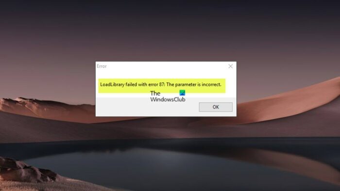

For some Windows 11 or Windows 10 PC users, when opening or creating a project or map document in ArcGIS Pro or ArcMap, the LoadLibrary failed with error 87: The parameter is incorrect error message may appear. This error is known to predominantly occur on 3D programs, including Chief Architect, AutoCAD, and Blender, running on AMD graphics-powered machines. This post provides the most applicable solutions to the error.
The error message could be either of the following.
- LoadLibrary failed with error 87: The parameter is incorrect.
- LoadLibrary failed with error 87: Wrong Parameter.

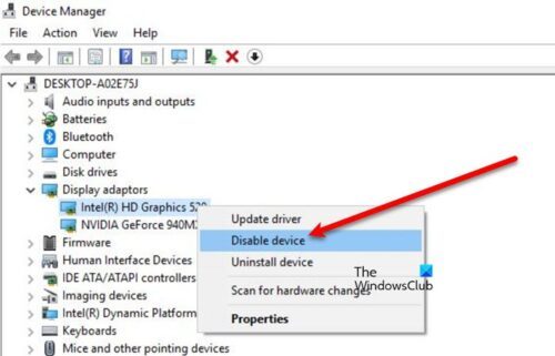

3] Disable the inbuilt graphics card
This solution applies when using Remote Desktop Protocol (RDP) to connect to a remote machine to remotely access any of the mentioned 3D desktop applications – the error could be related to the RDP session itself, as what may be occurring is a conflict between the video card specified by the RDP connection and the one used by the 3D software on the remote machine. RDP connects by default to a built-in Intel video card, not to the video card used by the 3D software. In this case, to resolve the issue, you can disable the AMD driver or the inbuilt Intel video card during the remote desktop session. You disconnect and then reconnect the RDP session after disabling the graphics adapter.

4] Resolve the issue of conflicting graphics cards
These 3D desktop applications rely heavily on the capabilities of graphics cards. Sometimes a conflict in graphics cards can cause these programs to crash, especially when a computer has a dedicated graphics card in addition to an integrated graphics card (for example, Intel with AMD FirePro). In this case, to troubleshoot to find out if the graphics cards are the culprit, you can carry out a series of disabling/re-enable/reboot steps to refresh the computer enough that the 3D program can determine which card to use when launching and displaying data.
Do the following:
- If open, close the 3D program.
- Next, press the Windows key + X to open the Power User Menu.
- Tap the M key on the keyboard to open Device Manager.
- Scroll down through the list of installed devices and expand the Display adapters section.
- Now, right-click and disable the first video card.
- Restart the computer.
- Open the 3D program again.
- Open Device Manager again and enable the first video card.
- Next, disable the second video card.
- Open Device Manager again and enable the second video card again.
- Open the 3D program once again.
If the behavior is resolved by disabling one card or the other, this could indicate the graphics cards are causing the issue.
