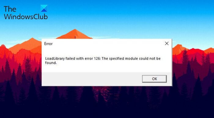

The Loadlibrary failed with error 126, 1114 or 1455 has been with Windows since years, and there are reports that people are still facing the problem even in the latest Windows 11. The error message occurs upon launching an application on a Windows PC. The accompanying messages may be:
The specified modue could not be found
A dynamic link library (dll) initialization routine failed
Below is a list of all the effective solutions you can try to fix Loadlibrary failed with error 126, 1114 or 1455 on Windows PC.
