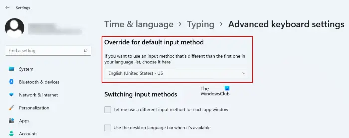

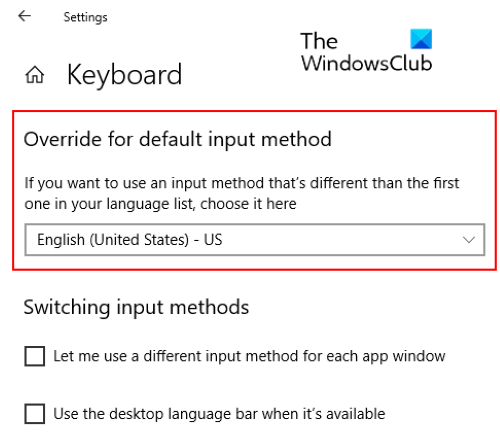

3] Override for default input language
Many users have found this solution helpful. Hence, it might work for you too.
Follow the below-listed steps for Windows 10 to set your keyboard to the default language of your system. Use the Override for default input language option and set it to English US.
- Open Settings app on Windows 10.
- Click on Time & Language.
- Select Language from the left side.
- Now, under the Language section on the right side, select Keyboard.
- Select English (United States) from the Override for default input language drop-down menu.
The following instructions will help Windows 11 users override the default input language:
- Open Windows 11 Settings app and select Time & language from the left pane.
- Click on the Typing tab.
- Now, click on the Advanced keyboard settings tab.
- Under the Override for default input language section, select the English (United States) language.
Restart your system and see if it helps. This has been known to help many.

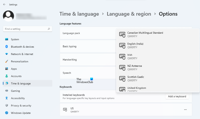

4] Check if you have selected the right keyboard layout
The problem of keyboard typing wrong letters also occurs when a user has selected the wrong keyboard layout on his system. You can check this in the Settings app.
Follow the instructions below for Windows 10:
- Open Settings app.
- Under the Preferred Language section, select your Language and click Options.
- If your preferred language is not added to the list, you can add it by clicking on the Add a language option.
- In the Keyboards section, click on the Add a keyboard option.
- Select the keyboard layout from the list.
If your computer runs on the Windows 11 OS, follow the instructions below:
- Launch the Settings app and select Time & language from the left pane.
- Click on the Language & region tab on the right side.
- Click on the three horizontal dots next to your preferred language and select Language options.
- You will see your keyboard layout under the Keyboards section. If it is not your preferred keyboard layout, click on the Add a keyboard button and select the correct keyboard layout.
