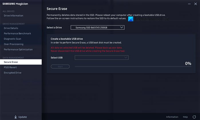

4] Secure Erase SSD and HDD
While it is essential, it is optional if you are not worried much about your data. While formatting deletes all the files, recovery software can still find files on the drive. So it’s important to use software to securely erase SSDs and HDDs.
Most SSDs come with OEM software that can easily and securely delete files. For example, Samsung Magician Software offers secure SSD erasure and the option to create a Windows-bootable USB drive. You can then use the USB to boot and install Windows. However, it works only with SSDs, not HDDs. For everything else, check out our recommended list of software that can securely wipe hard drives.

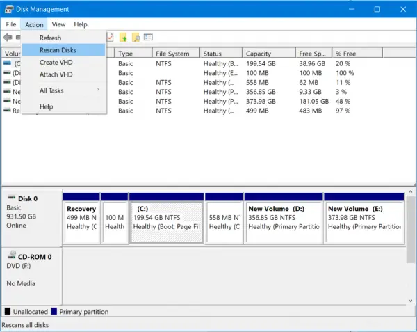

5] Format Data drive
If it is a Data drive you want to format (which does not have the OS installed, or a USB or external drive, then you can simply use the Disk Management Tool. Open it from the WinX Menu, select the Data drive, right-click on it, and select Format. This will wipe all data from the drive, so ensure you have backed up any important data.
