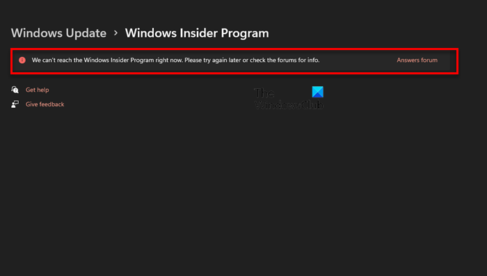

At times, your computer might encounter errors that are not yet acknowledged by Microsoft yet. One such case is with the 0x0 0x0 error code on Windows. In this case, we get the error code along with the error statement Something went wrong. Should you encounter the same issue on your system, please read through this article for the resolutions.
How to fix Error Code 0x0 0x0 on Windows 11/10
The error Sorry, Something went wrong, Error Code 0x0 0x0, is usually seen on Windows Insider Builds and the main cause behind the error is either bugs or system inconsistencies. We suggest checking the RAM and status of drivers to fix this problem. You can solve this problem by trying the following solutions sequentially:

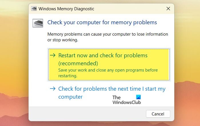

2] Test the RAM memory on your system
The error in the discussion can be caused by a problematic RAM. In this case, you can test the RAM of the system. It can be be tested using 2 tools. The first tool is the Windows Memory Diagnostic tool of the computer. The procedure to use this tool is as follows:
- Press Win+R to open the Run window.
- In the Run window, type the command MDSCHED and hit Enter to open the Windows Memory Diagnostic tool.
- Click on Restart now and check for problems.
The Windows Memory Diagnostic tool is a basic tool. The other tool is the Memtest86+ Advanced Memory Diagnostic tool which is a downloadable tool and does more extensive research in comparison to the in-built tool.
