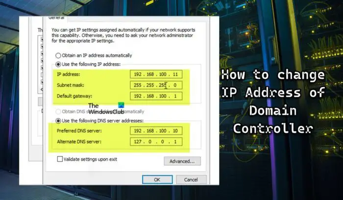

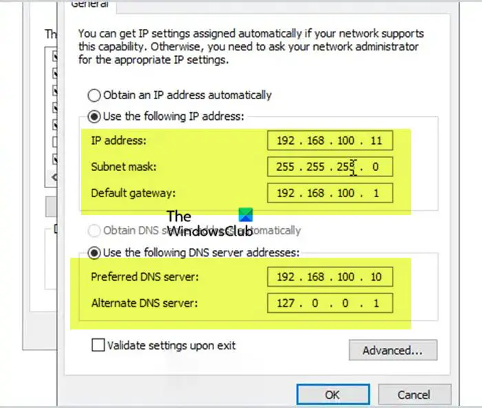

- In the Ethernet Properties dialog box, scroll down the list and double-click Internet Protocol Version 4 (TCP/IPv4).
- In the TCP/IPv4 dialog box, change the IP address.
- Change the Subnet mask and Default gateway if required.
Note: Change the primary DNS server entry to the DC’s new static IP address if the DC is also the only DNS server in the domain. And as per Microsoft best practice, the first entry for the DNS server, that is the Preferred DNS server IP address should point to another DNS server on the same site, whereas the Alternate DNS server IP should specify the loopback or LocalHost address.
- Click OK to continue.
- Click OK in the Ethernet Properties dialog box.
- Close the Network and Sharing Center.
