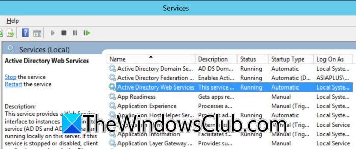

1] Start the Active Directory Web Services service
If ADWS is installed but stopped or disabled on the domain controller, we will have to start it on the server. To start the Active Directory Web Services service, follow the steps mentioned below.
- Log in directly to your domain controller.
- Now, press Windows + R.
- Now, type services.msc and Press Enter.
- Look for Active Directory Web Services.
- Then, double-click the service and set Startup type to Automatic.
- If the service is stopped, click Start.
Click Apply and then OK.
You can also do this from an elevated PowerShell window:
Get-Service ADWS
You should see something similar to:
Status Name DisplayName ------ ---- ----------- Running ADWS Active Directory Web Services
If it is stopped, run the following command.
Start-Service ADWS
Then make sure it starts automatically by executing the following command.
Set-Service ADWS -StartupType Automatic
Now test from the client using the following commands.
Get-ADDomainController -Discover -Service ADWS
If a domain controller is returned, try your original command again Get-ADUser administrator.
Now, check if your issue persists.

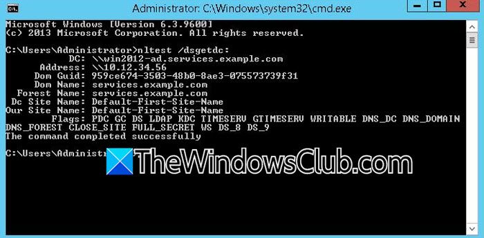

3] Check whether the client can actually discover an ADWS-enabled domain controller
ADWS can be running, and port 9389 can be open, but Windows may still be unable to discover the correct domain controller. This is where DC Locator and DNS become important. Microsoft recommends using nltest to determine whether Windows can locate a domain controller advertising the Web Services capability.
From the computer where the error occurs, open Command Prompt or PowerShell and run the following command to determine your domain name.
$env:USERDNSDOMAIN
You can also check whoami; suppose your domain is thewindowsclub.com, run the command nltest /dsgetdc:thewindowsclub.com /ws /force. The /ws option specifically asks DC Locator for a domain controller providing Web Services. If it succeeds, you should get information about a domain controller. You can also try nltest /dsgetdc:thewindowsclub/ws /force using the NetBIOS domain name.
If nltest cannot find a DC, check DNS next:
nslookup thewindowsclub.com
Also check the DC’s hostname nslookup DC01.thewindowsclub.com. The returned address should point to the correct domain controller.
If your computer is using an external DNS server such as 8.8.8.8 or your ISP’s DNS, that is a major red flag in an Active Directory environment. Domain-joined machines should normally use the organization’s internal AD DNS infrastructure so they can resolve the AD-specific records required for DC discovery.
After correcting DNS, clear the local DNS cache ipconfig /flushdns, then try nltest /dsgetdc:contoso.com /ws /force again.

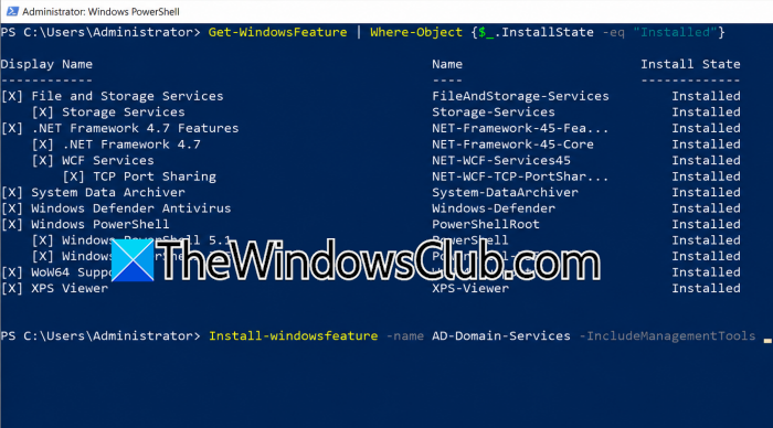

4] Check whether ADWS is missing from the domain controller
If you open services.msc and Active Directory Web Services isn’t there at all, this is a different problem from a stopped service. ADWS is installed automatically with the AD DS or AD LDS server roles on supported Windows Server versions. Therefore, its complete absence may indicate that the server isn’t configured with the expected directory-service role or that the installation is damaged.
Follow the steps mentioned below to do the same.
On the suspected domain controller, check whether the AD DS role is installed using the command: Get-WindowsFeature AD-Domain-Services.
A normal domain controller should show the feature as installed.
You can also check whether the ADWS executable exists Test-Path "C:\Windows\ADWS\Microsoft.ActiveDirectory.WebServices.exe"
If it returns True, the ADWS program exists.
If it returns False, and the ADWS service is also missing, verify the server’s AD DS installation before trying to repair individual services.
Check the role Get-WindowsFeature AD-Domain-Services.
If AD DS is not installed, install the required server role Install-WindowsFeature AD-Domain-Services -IncludeManagementTools.
Do not run this command blindly on an existing production domain controller. If AD DS is already installed but ADWS is missing, investigate the Windows Server installation and Event Viewer first rather than attempting to recreate the domain controller role.
