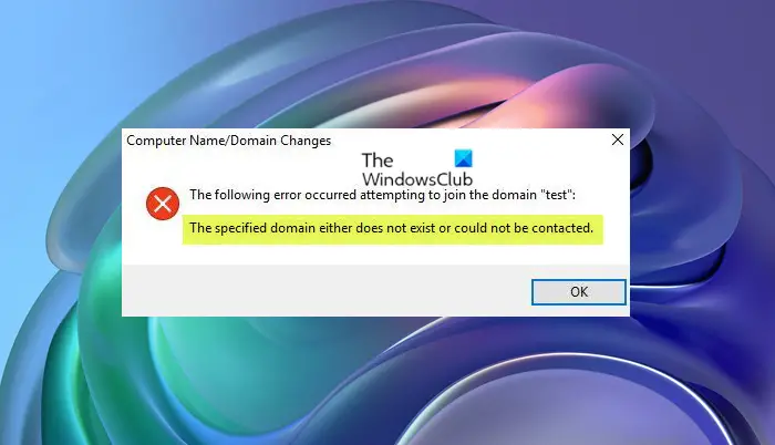

When you try to join a Windows-based computer to an existing domain, you may get an error prompt with the error message The specified domain either does not exist or could not be contacted. This post identifies the most likely culprits and provides the most suitable solutions to fix the error. The error prompt appears after entering the username and the associated password.
The error commonly occurs due to invalid DNS settings on the workstation, because Active Directory requires the use of the domain DNS (and not the router’s address) to work properly. The error can also occur because IPv6 (if configured) is not working.
Assuming that your Active Directory Domain Controller (and DNS Server) is a Windows Server machine and is responsible for the local domain and has the IP Address of 123.123.123.123. At this example, the IP and the Preferred DNS address on the Primary Domain Controller must be the same, otherwise, you may encounter the issue in view.
So, if you have encountered the “The specified domain either does not exist or could not be contacted” issue on a Windows 11/10 client machine you’re trying to join to a domain, you can try the recommended solution below to resolve it on the system.

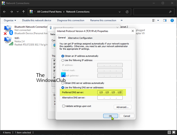

1] Set the Preferred DNS IP to match the Domain Controller’s IP on Client Workstation
This solution to resolve The specified domain either does not exist or could not be contacted issue on a Windows 11/10 client machine you’re trying to join to a domain, is to set the Preferred DNS IP to point to Primary Domain Controller’s IP address on each client workstation that you want to join in the domain.
Do the following:
- In the Run dialog box, type ncpa.cpl and hit Enter to open Network and Sharing Center (if unable, see Network and Sharing Center not opening).
- Right-click on Local Area Connection and select Properties.
- Next, double-click on Internet Protocol TCP/IPv4.
- Now, change the Preferred DNS server address to match the Primary Domain Controller’s IP address (run IPConfig to see the exact IP for your setup).
- Check the Validate settings upon exit option.
- Click OK all through to close all windows.
Now, you can go ahead and join the workstation to the Domain without the issue in view reoccurring.

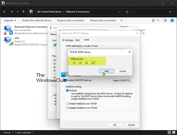

2] Specify the WINS Server’s IP address on Client machine
You can apply this solution if your Active Directory Domain Controller acts also as a WINS server – set the WINS IP address to point to the WINS Server’s (Primary Domain Controller’s IP address) on the client machine that you want to join to the Domain.
Note: This method works even when the Primary Domain Controller does not act as a WINS Server.
Do the following:
- Open Network and Sharing Center.
- Click the Advanced button.
- Click WINS tab.
- Click Add button.
- In the WINS server field, type in the IP address of the WINS server.
- Click Add.
- Click OK all through to apply changes and close all windows.
You should now be able to join the workstation to the Domain without the issue in view reoccurring.

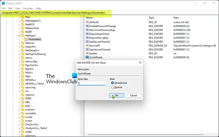

3] Modify SysVolReady registry key value on Domain Controller
SysVolReady indicates the replication status of the system volume on a domain controller. This entry appears only in the registry of a domain controller, and is set by DcPromo, Backup, and File Replication service (FRS) to indicate the replication state of the SYSVOL share. During replication, the system volume is not shared and the domain controller does not respond to DSGetDcName calls, which seek a domain controller in the domain.
This entry notifies the system that SYSVOL replication is complete. If a problem with the FRS prevents it from resetting this value automatically after replication, you can change the value of this entry to 1 via Registry Editor.
HKEY_LOCAL_MACHINE\System\CurrentControlSet\Services\Netlogon\Parameters
- At the location, on the right pane, double-click the SysVolReady entry to edit its properties.
- Input 1 in the Value data field.
The value 1 means the system volume is not being replicated – the volume is shared. The value 0 means the system volume is being replicated or receiving replication updates and is not shared.
- Click OK or hit Enter to save the change.
- Exit Registry Editor.
- You may have to reboot the Domain Controller.
After the DC restarts, you can now successfully join the client machine to the domain.
