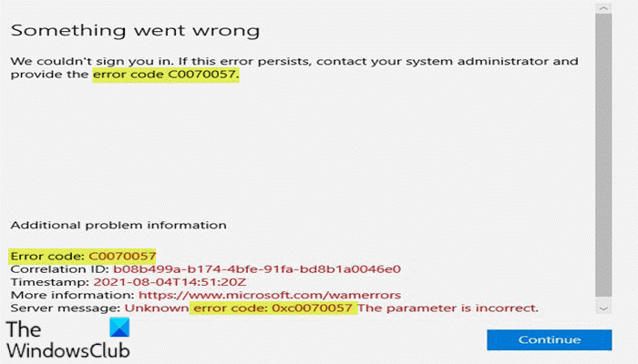

Some Microsoft Office users have reported the issue whereby on their Windows 11 or Windows 10 computer when attempting to sign in to Microsoft 365 apps, they encounter the error code 0xC0070057. If you’re experiencing a similar issue, this post is designed to help users resolve it successfully.
Something went wrong
We couldn’t sign you in. If this error persists, contact your system administrator and provide the error code C0070057.
The error message also appears when logging into Outlook directly instead of adding the account via the settings.

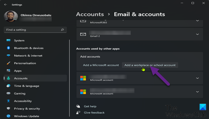

2] Log out and log into the Office app with Work or School account
This solution requires you to log out and log back into the Office app with Work or School account.
Do the following:
- In any Office app, go to File > Account (or Office Account in Outlook) > Sign out.
- Close all Office apps.
- Restart your device.
- On boot, navigate to Settings > Accounts > Email & accounts.
- Select Add a workplace or school account.
- Now, log in using your credentials.
You should now be able to sign into the Office app without the error. If not, try the next solution.
